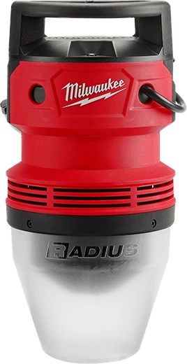

These aren't string lights. Theyre individual fixtures with a feed through outlet. You can run a bunch of them together with cheap 16ga ext cords.
Your low voltage landscape wire is not a listed wire or cord type that you can use for line voltage temp wiring.
Milwaukee makes a similar portable high bay that is made to be hardwired, its often used with MC cable, but its twice as much $ as the one i linked,

Haha uhoh u posted milwaukee tools now i have to buy them.

Ah ok so the issue with that first light I posted is when its line cord gets damaged you can't replace the cord end on it?
I wonder if theres one with a 5-15 inlet instead of a cord.
