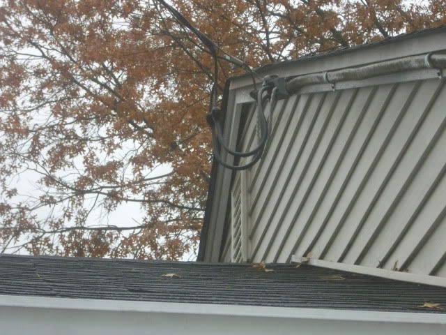

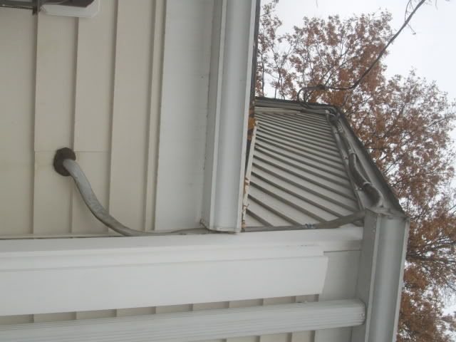

Another SEC question
I think we saw other pics of this install in the recent past.
Looks like possibly unsupported cable from the hole in the house up behind the gutter and to the first incorrect cable fixation device.
I am more worried about where it goes into the house. What prevents water from running down the cable right to the glob of sealant?
i am not overjoyed with tucking it along side the gutter either. The cable might well be subject to mechancial abrasion there.
