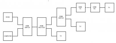

I run an HDMI splitter to a TV and a wireless HDMI transmitter from a switch that selects between a Roku and a computer; it works fine.

FWIW, the setup I showed in post #6 works reliably. I can get a signal from either the Roku or the computer to the TV in the living room and to either the TV on the deck through a cable or to a TV elsewhere in the house through the wireless HDMI transmitter and receiver. The switch, the splitters, and the wireless HDMI are cheap ones from Amazon. Occasionally I have to cycle power to the HDMI transmitter to get it to pair with the receiver.
