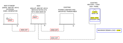

See attached image for sketch of elec. one line diagram, does anyone see any code issue?
I.e. using new 400A services (both normal and generator power) to power an existing 1,000A panel with 1,000A main breaker because
max. demand load of the panel is only 210A. No need to comply with coordination study in this case? Thank you.
