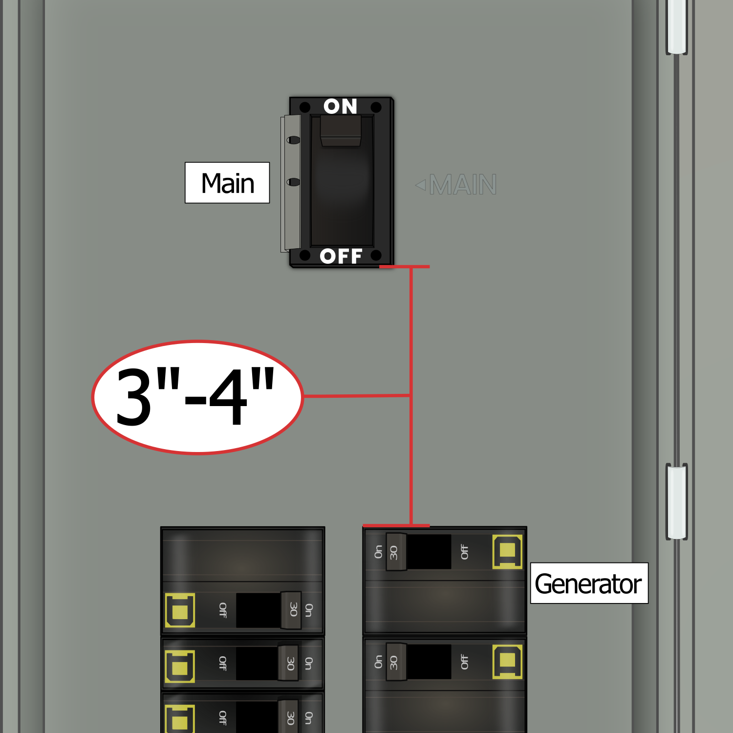

LarryFine Master Electrician Electric Contractor Richmond VA Location Henrico County, VA Occupation Electrical Contractor May 8, 2025 #2 Have a ruler handy? Measure between the main and branch openings. Interlock Kit K-5210 | Interlock Kit Use Interlock Kit K-5210 for reliable generator integration. Fits Square D QO 150-200 amp panels with precise spacing. Order now for swift shipping! interlockkit.com Interlock Kit K-5410 | Interlock Kit Ensure secure power management with Square D Kit K-5410. Compatible with various QO panel sizes. Fast shipping available! interlockkit.com

J jim dungar Moderator Staff member Location Wisconsin Occupation PE (Retired) - Power Systems May 8, 2025 #3 That looks like it is 40 years old. Factory interlock kits weren't common back then.
