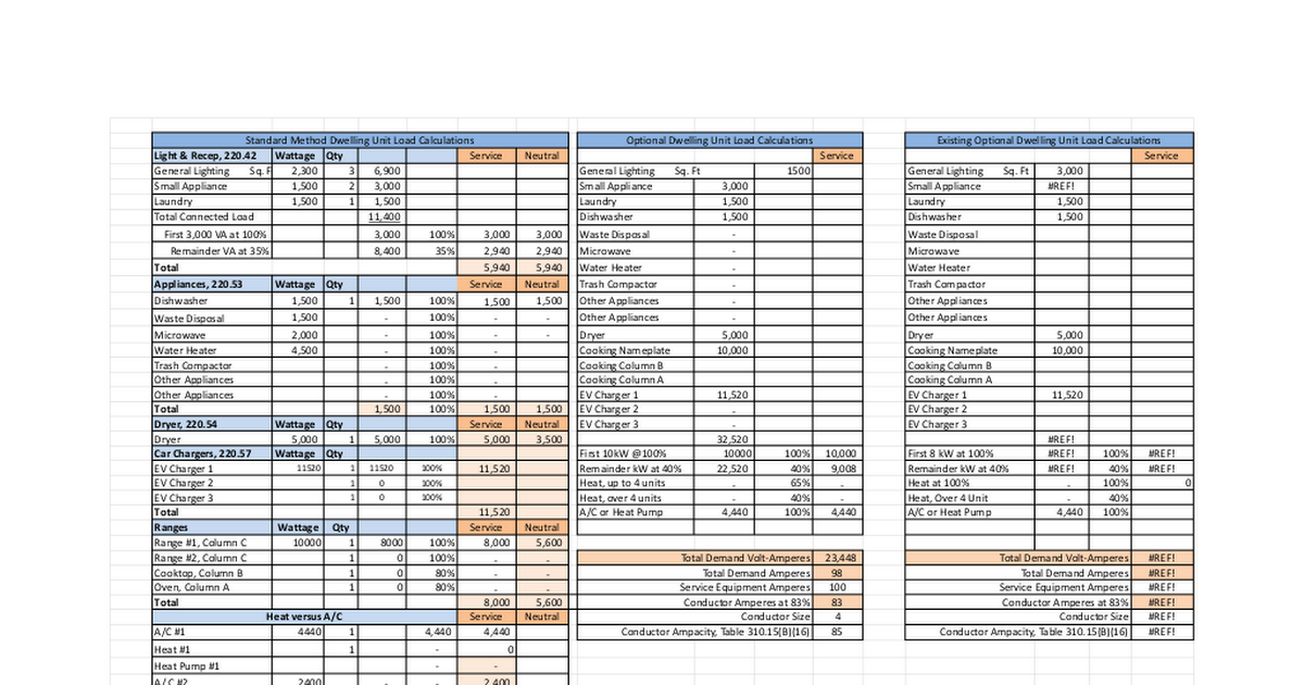

Is there a good app for this? I know a lot will say just do it manually but with all the EV chargers lately it's nice to have a quicker method.
I have an excel spreadsheet from Mike Holt that has numerous other sheets. Calculations for banks, school, dwellings etc.
Mike said to share it with everyone. I modified it a bit and tested it fairly well so I think it is pretty accurate.
Btw, I only modified the dwelling sheet.
If anyone wants it I have it on my goggle drive. I would download the file since you may lose some results if used in google docs. IDK
