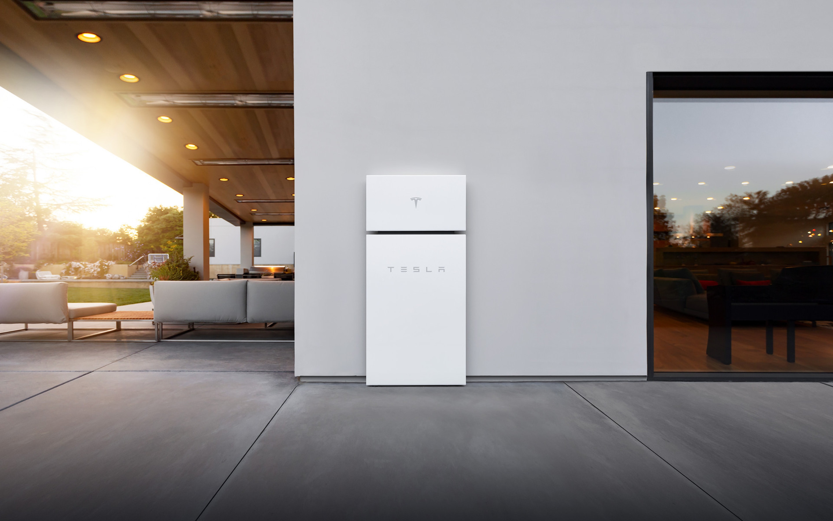

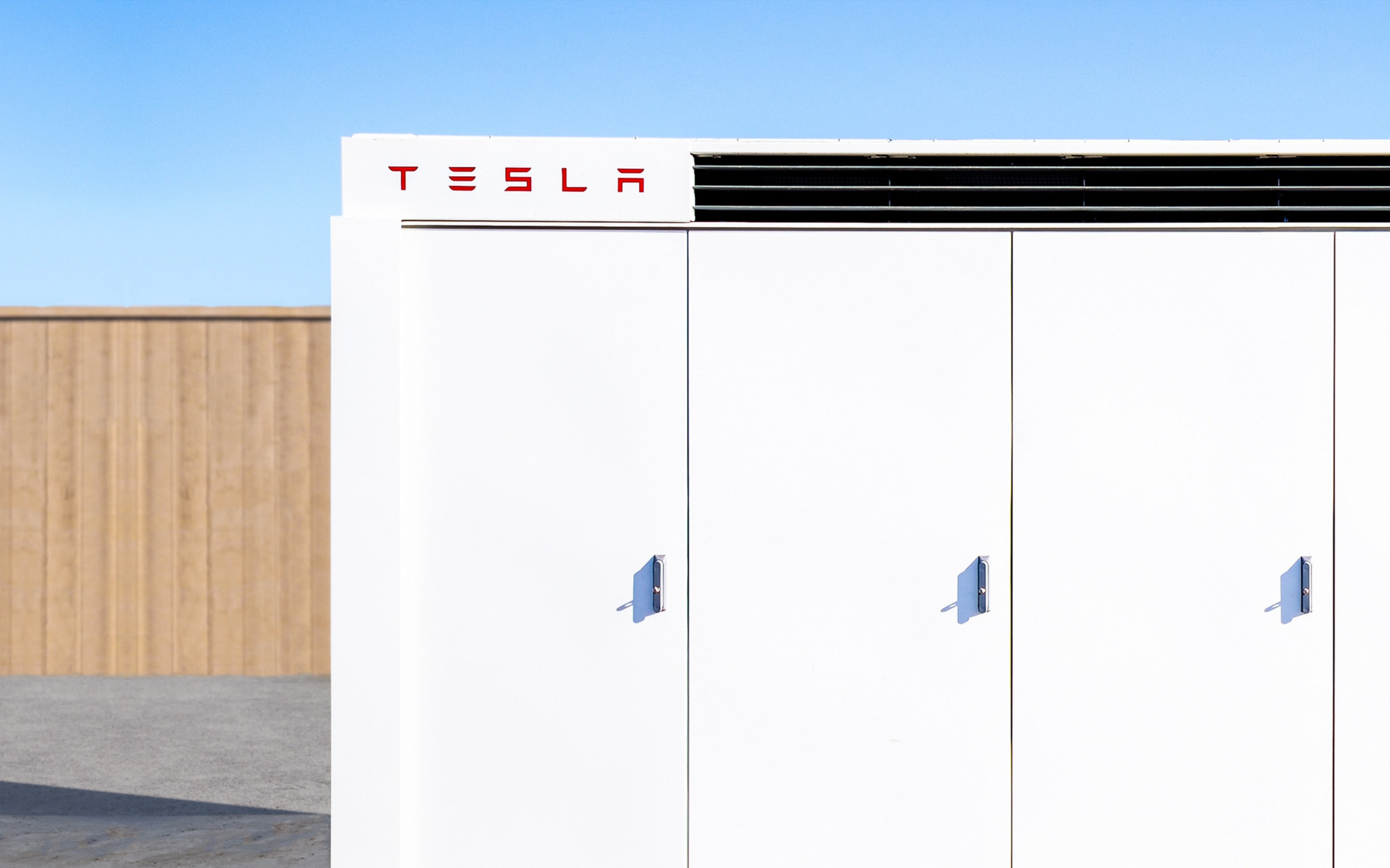

Link? I'm old school bro!
Hmmm, and i thought i was the guy always laggin' MBrooke :)
sure>
with or w/out solar>>
~RJ~
