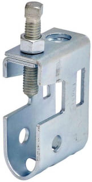

A sheet metal beam clamp also makes a excellent hanger choice if you get the type that sprinkler fitters use, for hanging threaded rods for pipe supports. They have two holes in the bottom of them for the threaded ro to pass through, and they give you a good set of holes for you to hook the hanger spring securely in.
