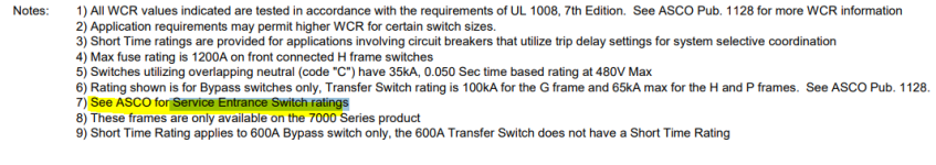

hello wondering if anyone has come across service entrance switch ratings for Series 300 and 7000. Thank you in advance for any help
I am looking for ASCO series 300 and 7000 Service entrance switch rating(s). The WCR rating (https://www.se.com/us/en/faqs/FAQ000102771/) mentions see ASCO for service ratings
There is a recent announcement on updating the Service entrance WCR ratings for 70 A - 600 A but i cannot find any WCR rating on service entrance switches for rest of the ampacity ranges
