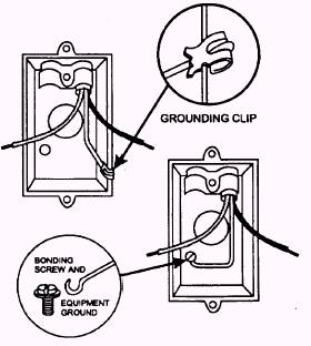

Re: Attaching grounding pigtails
You might also consider using a grounding clip:
