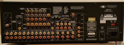

Very nice, whats the small yellow cord on the bottom right of your panel?
It feeds the panel from the 12v DC switched trigger output of my preamp-processor. The output is only capable of 15ma, so the yellow cable energizes a reed relay, which energizes a 10a cube relay, which in turn energizes a 4-pole 20a contactor, all inside the panel.
Four of the eight 15a circuits are switched through this contactor, and supply the two power amps, the two sub-woofer amps, and a few other components, like the plug-in LV power supplies, so the power switch on the preamp-processor can control the entire system.
I used the G.E. sub-panel because the breakers being offset from the center provided enough room for the relays and the contactor to fit inside the enclosure. I thought the cable channel was a good way to keep the power cords neat and away from the signal cables.
Why the recp outlets instead of plug strips?
I would still have needed several receptacles, some circuits only feed single components, like the power amps, the projector, etc., and I still would have needed a separate strip for each circuit supplying more than one component, so there would be no real advantage.
Each power amp has its own dedicated circuit, and the sub-woofer amps (built into the main speakers) share one. The main amp is rated at 300w x 2, the center/sides/rear-speakers amp is rated at 200w x 5, and the two sub-woofer amps are rated at 300w each.
That's a total of 2,200 watts of continuous power. The system will play at full, realistic concert levels without breaking a proverbial sweat. I have replaced the preamp-processor in the picture with a Fosgate FAP-T1+ unit that has a wide-screen monitor on the front.
