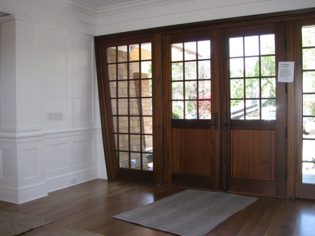

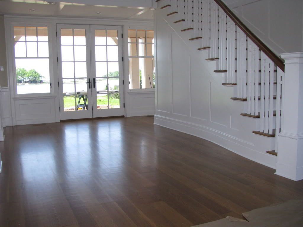

Here is three different angles of an "area" of a new house. Is this a HALL, FOYER, ETC...?
Meaning does this "area" require receptacles?
Front door:
Other part of the "Area" - 1
Other part of the "Area" - 2
Looks like a hallway to me. Personally, I'd have tried to talk the owner into a few more, since decorations get set around that need electricity in these sorts of areas. I think what I see is compliant, however. At least it would be okay with me.
