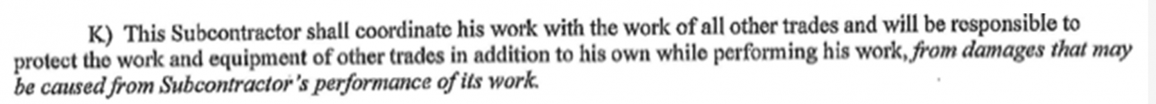

If you are altering the existing utilities, then certainly the changes need to be coordinated with the other trades. On the other hand, if the work of other trades collides with existing portions of utilities that you are not moving, that's on them."Existing utilities" is not coordinating with trades on the job.
Grilled cabbage ...lolFor a split second, I thought Beef was for supper, but I couldn’t grasp what GC was.![]()
So your agreeing with my stance ?Silly me, I though it was the GC's job to coordinate the work.
Pretty much; my job is to do electrical stuff, not to know who's working where and what's going to interfere.So your agreeing with my stance ?
Thanks. That's our stance.i am a general contractor an i coordinate all phases of construction because i am responsible for them
It sounds like all of the trades are in the same boat with this GC. You all need to get together and tell the GC to do their job.Thanks. That's our stance.
I really don’t want to fight with you guys. Coordination of your work is industry standard. This is a renovation project … there are unforeseen conditions in the ceiling- that’s not abnormal - we know that. These are affecting the mechanical routes … in some cases your install of fixtures, etc. rather than require rework by all parties - I’m having a hard time understanding why we are arguing over verifying existing conditions when availble despite your contract requirements that call for coordination between trades.
It would be in all of our best interest to work together - avoid conflicts in the field that add delay … and if you feel your entitled to money do to existing conditions - submit it. Otherwise we are spinning our wheels.
The OP kind of wrote in short hand with a lot of typo's though, so I don't think we necessarily understand exactly what he is saying, he mentions "hits". I almost get the impression he mean they expect him to check everyone's systems and make sure existing electrical doesn't interfere with them. It that is true, I would say, "No!" But, unless he spends more time and makes the issues clearer, we are merely speculating. That is why I hadn't input before this.This is industry standard and the GC is correct. He plainly states at the end if you need additional payment to modify unforeseen conditions to submit a change-request.
The sense in which the word "coordination" is used is to say that you will discuss and/or meet with other trades to confirm what each of you is doing before starting work. The GC is very likely going to schedule a meeting for this to take place, but the wording is there to make sure you understand not to blindly start work without a discussion between everyone, and to hold you accountable if you do so without discussion. This is just good general practice anyway.
It probably states somewhere in the job specifications that submission of a bid affirms you have reviewed existing conditions as well.
GC is not saying you have to do the work for free, he's saying you need to at least spend the time to see what's up there before causing any damage, which is reasonable and expected in renovation work.
