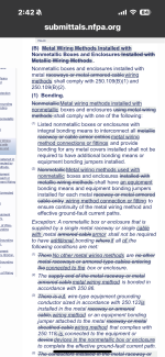

Yessir that’s the way I read it as well and i actually spoke to Ryan a couple weeks ago in regards for 314.3exception 1 and he confirmed the rules intent is to keep everything electrically continous and the internal method of bonding between the entries is the wire type egc which extends into the plastic enclosure and that satisfies exception 1 , but he did agree the langauge needed work and it’s been re written for 2016 and they moved the rule to 250.109(b)
