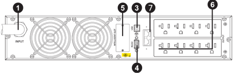

The input of the UPS is an assembled flexible cord with a L15-30P plug (with a ground prong).
The output of the UPS is not a feeder, it does not contain a main breaker. It simply has multiple 5-20R receptacles, each with a ground slot, to which PDUs (power strips for telecom) are connected, to which IT equipment is connected (switches, routers, servers).
Additionally, the chassis of the UPS has a ground screw, internally tied to the input and output grounds, and the chassis, of course.
The UPS is from the manufacturer CDP (Chicago Digital Power), model UPO11-3RT (3kVA, rack-mount).

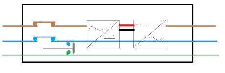

Any applicable requirements should be included in the owner's manual, but assuming you meant L5-30 rather than L15-30, and going from my memories of the schematics I saw 20 years ago...
- Opening the thing beyond any user-serviceable parts (aka the batteries) will void UL. Do not pass 'GO', do not collect $200.
- Unless UL requirements have changed versus 2005, during online operation the ground and neutral are carried the whole way through as if the UPS were just a sort of fancy-pants line conditioner. When the power goes out and things switch to battery, not only is the hot physically disconnected from the input, BUT SO IS THE NEUTRAL. This is to prevent any sort of objectionable backflow current from getting onto the upstream lines.
- This part is fuzzy, but IIRC there was a second relay to physically bond NG during battery operation only.
I would think...
1) The neutral and EGC should be factory bonded inside the unit.
2) The unit should have a grounding electrode conductor (GEC) terminal for grounding the separately derived system.
(Maybe the product standard doesn't actually require (2), I don't actually know.)

Figured I would bust out my skills of an artist (bonus points if you recognize the quote). Obviously things may have changed in the 20 years since I last mucked about supporting these things, but this is how I remember a single-phase double-conversion system looked "back then," input on the left, output on the right, and using euro-style coloration (brown hot, blue neutral, green ground)
