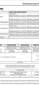

Let me ask another question. These are probably class 2 circuits. Is there any code requirement to actually run an EGC with class 2 circuits?
The circuits come off a class 1 power supply in the PLC which my understanding is they automatically default to class 1 but they are all 24VDC
I think if you look very closely at what the code says, they are still class 2 circuits.
We haven't established that his power source has those limits. I agree there's a good chance you're right, but the code does not say that a Class 1 power source becomes Class 2 just because it's part of a PLC.
