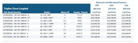

I have the following posted on plans:
Booster pump is pro-22TJ15xxx-6h-xx-swf55-3 which is triplex booster system utilizing (3) 15HP pumps and rated at 208V/3PH service, will use 80A fuse for the internal motor protection.
More specifically they use Bussman Model LPJ-80SP fuses in control panel. See below for data sheet for this fuse
an 80 amp fuse for overload protection will get a violation notice from me
According to their catalog, that pump panel has VFDs on each motor, so the fuses are just the SCPD for the VFDs, probably because that's what the VFD is listed with. The VFD will be protecting the motor.
Depending on the purpose of the triplex panel, it may only alternate two p[umps and never run all three at the same time, but if you don't know that for sure, you would size the feeder conductors for the 3 FLAs combined plus an added 25% of one of them and any other loads like a control transformer etc., (430.24) or stated another way 125% of the first one, plus the other loads added to it. So 46.2 x 1.25 = 57.72 + 46.2 + 46.2 = 150.15, then because it has control power too, I would give it at least 175A rated feeder conductors. Then per 430.62, you size the feeder protection based on that. If it were me though, I would go for 200A conductors and feeder breaker.

The model number for the panel by the way appears to have a "200A" in the middle of it, so that might indicate it has a 200A main. The description says it has a "single main power feed".
