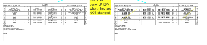

Why? because it's rated for 25A @ 75 degreesIf the wiring is #12, I don't see a reason to change to 15A breakers.
Someone might have found 14ga wire downstream.Would it make more sense to leave in the 20A and if not why?
That was the case in a earlier threadThe VAV's might have a maximum OCPD size of 15 amps. You should check the cut on the VAV's.
Look at 240.4(D)Why? because it's rated for 25A @ 75 degrees
