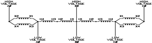

Ah yes, I should have provided more detail on the connection. Two 15 kVA 600-120/240 transformers in an open delta, connected as shown below. LV: 480V, HV: 575V. The capacity should be about 125 kVA if I'm doing this right. 15000 VA/120V=125A. 125A*575V*1.732=124.488 kVA.

Here is one. Based on the step ratio, you will use 20% dV, so that 15kva transformer /20% is capable of 75kva of load as single phase. If in 3P, that is 75kva*1.732=129.9kva available to load.
I think you are tossing amps in the mix, where you can keep everything as kva to keep it simple.

An open delta configuration, as shown in the diagram, only produces 57.7% of the kVA of a closed delta.
Closed would use 3 transformers with no sq rt factoring.
Assuming equal sized single phase units.
A closed delta simply provides 3X the rating of a single transformer.
An open delta provides 57.7% the rating of a closed delta.
An open delta provides 86.6% of the rating of 2X a single transformer.
