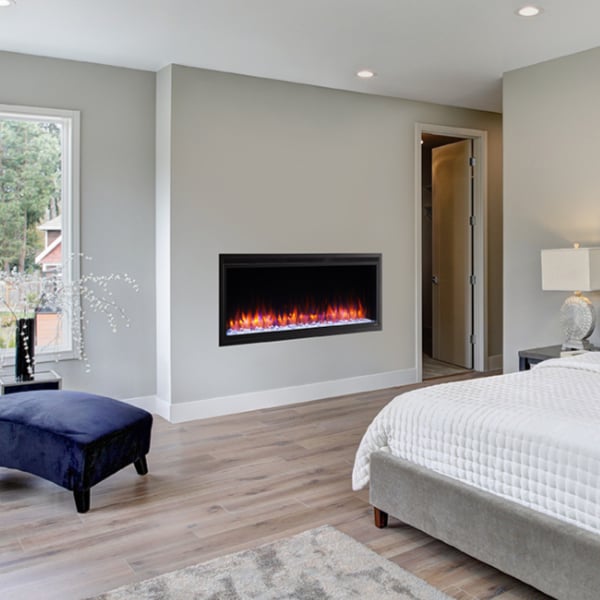

I have a built in electric fireplace going into a home, and the specs say 1500 watts and it needs a 15 amp circuit. I'm confused though, wouldn't this need a 20 amp circuit as it is considered a fixed electric space heater and would have to be a minimum of 125% of the 1500 watts? I'll attach a link to the specs.
Thank you
This is my thought as well, I won't have access to the unit until we finish the house in a few weeks. Just wasn't quite sure why the company spec sheet would call for a 15 amp circuit

If you are roughing in at this point I'd run 12 AWG can always change the breaker if needed, though I'd probably also put in a 20 amp breaker.
It is not for primary heating, so in my opinion the 25% adder for electric heating equipment does not apply.
NOT INTENDED FOR USE AS A PRIMARY HEAT SOURCE.
This appliance is tested and approved as either supplemental room heat or as a decorative appliance. It should not be
factored as primary heat in residential heating calculations.

I think it can wire up either way hardwire or cord connected according to the brochure. I’m just unsure of what the nameplate will say. I believe it just has a remote control as far as the “on/off”
Would I still need a disconnecting means at the unit? Say a single pole switch, or would a lockout suffice?

I spoke with my inspector. Says it’s a continuous load and has to be at 125% regardless
