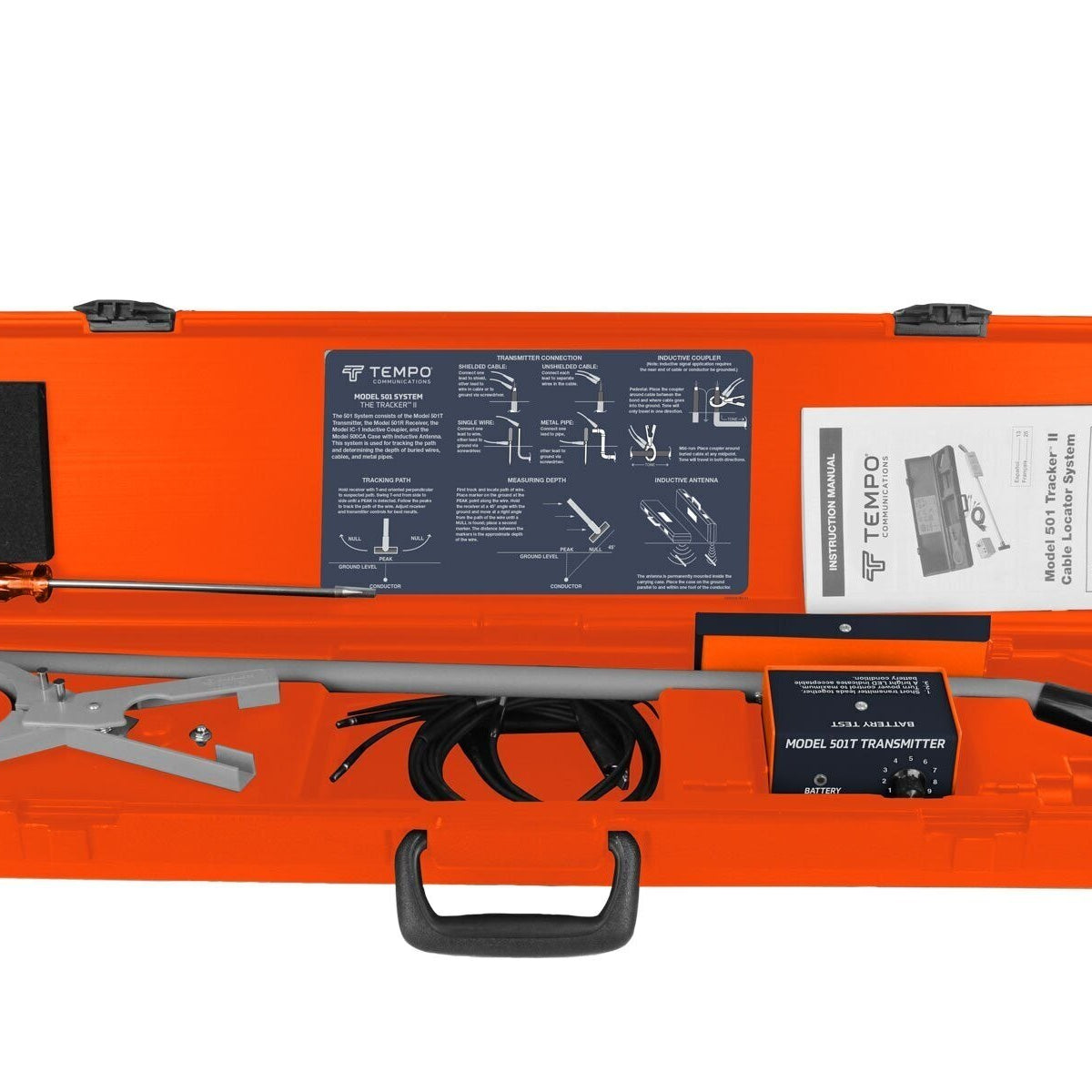

This is the tracer I use, works real well. If you do a lot of underground work, it’s worth the money.

We'd hook our locator to it that also gives depth measurements and dig right to it.
We've done it in the past, it works well.
If you don't have a locator or can't find one to rent, I'd see about hiring a locating company to come take care of it for you.
Mines an Ideal. Relabeled, I’m sure. Worth the bucks, but if you can afford it, Cow’s is a couple notches up on the pole.
