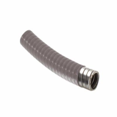

Can I bury Ltfmc? Do I need special fittings to use it under ground. Any words of advice and cautions that I need to take. The only reason I ask is because we have piping underground and can not get around them with pvc or rigid but the flew does fit

See 350.10(3), however I am not sure that the connectors are suitable for underground use. Also remember that the degrees of bend in the LFMC count towards the maximum of 360° between pull points.
We are looking at about 270degree max I’ve reached out to T&B for cut sheet and spec hopefully that will clarify. Others have said they’ve done it with no known issues. I’ve have never tried

I know I have used NM that is listed for DB but don't remember seeing the DB listing on any of the Metallic I have installed. I have never seen a metal connector listed for DB.
I personally would never bury either. I have use short runs of NM in curved concrete walls to connect lighting boxes.
What size raceway are you installing? Unless it is very large I could bend PVC to fit.

Here is one source for DB rated flex there were others.
My question is how are you bonding that section of flex to the EGC? [2017 NEC 250.4(A)(2),(3)]
LFNC non-metallic only found sizes up to 2 inches, so that probably won't help.
I don’t think it’s likely to become energized… but honestly didn’t consider it….I’ll have to dig around and find someway that the ahj will approve

(2017) 250.86 Exception 3(1) would permit the short section of LFMC to be unbonded if it has at least 18" of soil cover?
Cheers, Wayne
yes, if the raceway is non-metallic, but that has nothing to do with my comment. The "likely to be energized" does not play any part in the code requirements for a metallic raceway to be connected to an EGC.

Well everyone. We ended up rerouting customers pipe. Nobody was 100% comfortable bring LTFMC underground had schedule 40 pvc heated up and very meticulously bent it into place Fun fun fun
