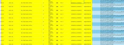

How do you handle derating for conduit/wire ran in PVC coated RGS on roof? It's a lot of footage on the roof but probably only 50% of toral run.
What we nyc is on. 2010?What code cycle?
Have to check on conductor insulation...they are on racks so there is a row about 1' the another about 2' then another about 3'What type conductor insulation (XHHW is 'different') ? and how high is the conduit above the roof ?
You would need to apply the derating based on the temperature adder in the table.Below is example of run. 2500 is trip amps
