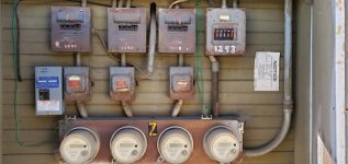

Hello,
Can I make my own KOs on this meter can? I am going to replace 5 old subpanels with 5 of these square Ds homeline meter breaker combo.
I want to line them up on the bottom with the feeder wires running through the bottom of the cans with chase nipples and bring in the branch circuits from the top making my KOs. But not sure if all that is going to fly with the inspector.
Thanks!

I take it you are running service entrance conductors to the meters. In that case you cannot run branch circuit conductors through the meter sections. 230.7. So unless there are partitions inside that allow you to run out the top without being in the same section (unclear to me from spec sheet, but I would guess there aren't), then... No, your plan doesn't work.
If it were not for that, say if there are partitions around the meter....It would be okay to make your own KOs in the top as long as you used sealing connectors such as myers hubs.

If for whatever reason I had to use those panels you show and depending on heights of things, I'd replace the existing breaker panels with pullboxes. Run pipe horizontal traveling left from those. Below the horizontal branch circuit pipes mount a trough for your service entrance wiring. Set the new meter combos below the trough. Reroute the existing service entrance conduit into the trough. Bring your branch circuit pipes down around the leftmost meter and back up into the breaker sections of those panels.
Or better yet use meter panels for U/G feed such as SU816F100PS and set a trough below them.

If you look at the technical drawing, there is a note on the left hand of the page that states, "OPTIONAL OVERHEAD BARRIER TUNNEL KIT. ORDER CAT NO OHBS WHEN REQUIRED FOR LOAD WIRES TO EXIT TOP ENDWALL. CONSULT UTILITY FOR APPROVAL."
That would allow load wires to exist the top but not the service conductors enter the bottom.
