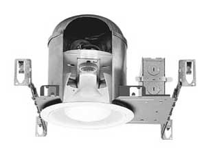

I just had a thought regarding can lights - specifically new work can lights - and their junction boxes. How does the code reconcile the junction box placement on those cans with the fact that junction boxes must remain accessible? I'm thinking of lights like this:
http://www.residential-landscape-lighting-design.com/store/images/HALO_H27ICT.jpg
I can think of plenty of cans with j-boxes I can't service without tearing out drywall. Why is that OK? I can't bury a 4" j-box in the ceiling, after all. Are these cans built to supposedly be able to remove the can to gain access? I just don't see that happening in the real world.
SceneryDriver
You pull the trim out, then disassemble the can from the frame and work on the J-box from there. That is why the J-box has covers on both sides.
Not saying it is easy, just how it the NEC looks at it.
I can't think of any can that doesn't have access to the JB. The problem is when they use that hard foam. Then it becomes a mess-- I will not install a can in that stuff.
I suppose that's true. It's that reality makes theory rather unpleasant at times.
