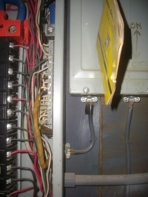

Can these tango?
Two services on the same building must be tied to a common grounding electrode.
I believe they are but they are using the ground bar in the panel. 250.64(C)(1) in the 2011 allow this connection for connectors that are listed for grounding and bonding equipment.
Now is a ground bar or neutral bar considered a connector-- IMO, yes. Is it listed for grounding and bonding-- I would think so-- thus the install should be legal, at least in 2011-- the rest is a guess.

I can't speak for circa 1975 or even Dennis 2011 Code section, but the way I read 2005 and 2008 it would not be permissible.
From handbook commentary it appears it is not permissible to route the GEC in a manner that removal of one panel/switch will interrupt the path of another,
Well I just spoke to NFPA and they were confused as well. They got back to me and said if the ground bar was listed for grounding and bonding then it would be compliant-- I can't imagine the bar is not listed for grounding and bonding but who knows. They were talking 2008 NEC

I thought a common grounding electrode conductor of 3/0 could be tapped with whatever size was needed for the individual discos if a gutter was used. That way, this would be met.
Honestly, the fact that there was bonding at all, is good.
Dennis,
I think "location" may be the key here. The fact that the bar is listed for grounding but is inside a panel I think makes a difference based on the wording in 250.64(D)(1) {08} "A tap conductor shall extend to the inside of each service disconnecting means enclosure."
In 250.64 it discusses the taps to each enclosure. That and the handbook pictorial lead me to believe that the connections must be made independent of the service disconnect/switch. I can not, however, find specific wording to support that beyond what I quoted.
