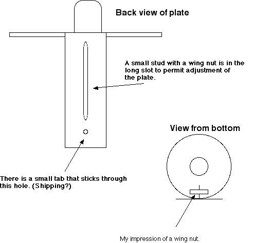

Has anyone else had issues with cans left on for a prolonged period melting the thermocouple, shorting itself to the can casing?
We use Capri Quicklights (QL1, I think) with a regular white baffle, and use a 65W R30 bulb, where the max is rated at a 75W R30.
I think someone turned it on, forgot about it, and the can just sat there and festered. The label inside the can melted down to a memory pattern, the insulator around the thermocouple melted through, and the can trim has a hat shape when removed from the ceiling, now. :(
My thought is, cans aren't supposed to be on for days at a time, and this occurred in a spec that's been sitting there for months. On one hand, being left on for days unattended is kind of abnormal abuse.
On the other hand, that thermocouple is supposed to prevent this meltdown from happening in the first place. It's an IC-rated can entering the attic space, insulated with that blown paper crud. It's IC-rated, with a bulb 10 watts below it's max.
What's everybody else's take on this? Defective can or abnormal abuse? As far as the GC is concerned, I told him that the cans aren't rated for continuous duty, and to turn the damn things off when the house gets locked. He asked, "What kind of cheap crap are you installing?" I had to partly agree, at least to myself.

1st, Make sure the insulators didn't bury the cans if it's blown-in insulation. It will cause problems everytime, usually "Blinking" on and off if the thermal overload is working properly.
2nd, did you "Adjust" the height of the bulb (Up) PAST the point where it is allowed to be? I've noticed they all have a little "stopper" thing that sticks out to prevent raising the bulb past that point. Check the Manufact's directions if you did to see if that's allowed.
3rd, Different brands of bulbs might reflect more heat "down" then others do. If it's happened more then once consider changing bulb brands.
I'de say it was also a defective thermal too. Unless it was covered with paint or other crap that gets sprayed on the ceilings. I started leaving the cardboard circle inside the cans on rough-ins to keep them safe from that stuff.

Only one can has been affected in this situation. I have had others issues in the past with other trims, but that would take awhile to explain. The key is, this is the standard setup of 95% of the cans I install.
This picture might illustrate what I'm dealing with a little better:
There are a couple of stops, but I don't think they are intentional stops to the installer.
The first on is the small hole on the bottom of the vertical plate. There is a small tab that sticks out, so that I have to loosen the wing nut quite a bit in order to jump that tab, and get the plate to rise above it's shipped setting.
I also have to slide it straight up, as there are small protrusions from the can housing that prevent it from going higher unless the plate is straight when going past them.
You have an interesting point, Dave, because it's how I was trained to trim out these cans, and if the factory didn't intend for that to be, we've got a problem. The reason we slide it up to it's max altitude is that it looks wrong if we don't, the bulb sticks down below the trim.
It may sound like the two "stops" are there for a reason (as in "How could you be so stupid, George?"), but I always thought they were to retain all the parts during shipping. They are simple to rise above, and the long slot in the plate obviously allows for a much higher max height of the bulb inside the can.
But I will look into this, as a possible cause of the problem. Thanks for all the replies. Once I get the part numbers on Monday, I'll give the manufacturer an e-mail.
