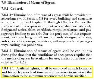

Check out Life Safety 101. Exit lighting are on full time.
Sorta. It must exist full time, but it doesn't necessarily need to be electric lighting full time.
From NFPA 101, 2006:

I don't disagree with anything. I'm simply saying that the light can come from natural light and that the lights do not have to be on at all times.
