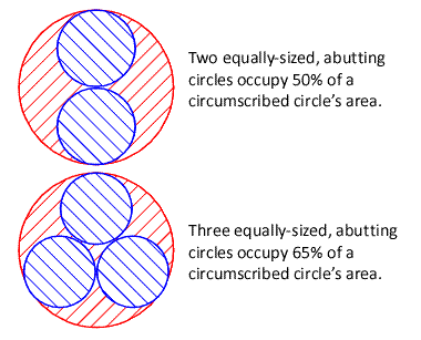

Here's my question: Why 31% for 2 conductors which is less cross-sectional area than 40% for 3? In other words, it seems like for 2 conductors you must use less than for 3.
3 or more conductors tend to pull "flat" through a raceway. 2 conductors tend to twist and form a double-helix. Think "DNA". This double helix configuration adds tension to the pull thus requires more space than pulls of three coductors or more.
Thanks. I've wondered that for years...now I know. :smile:
Looking at it from a geometrical standpoint helps to understand why...
