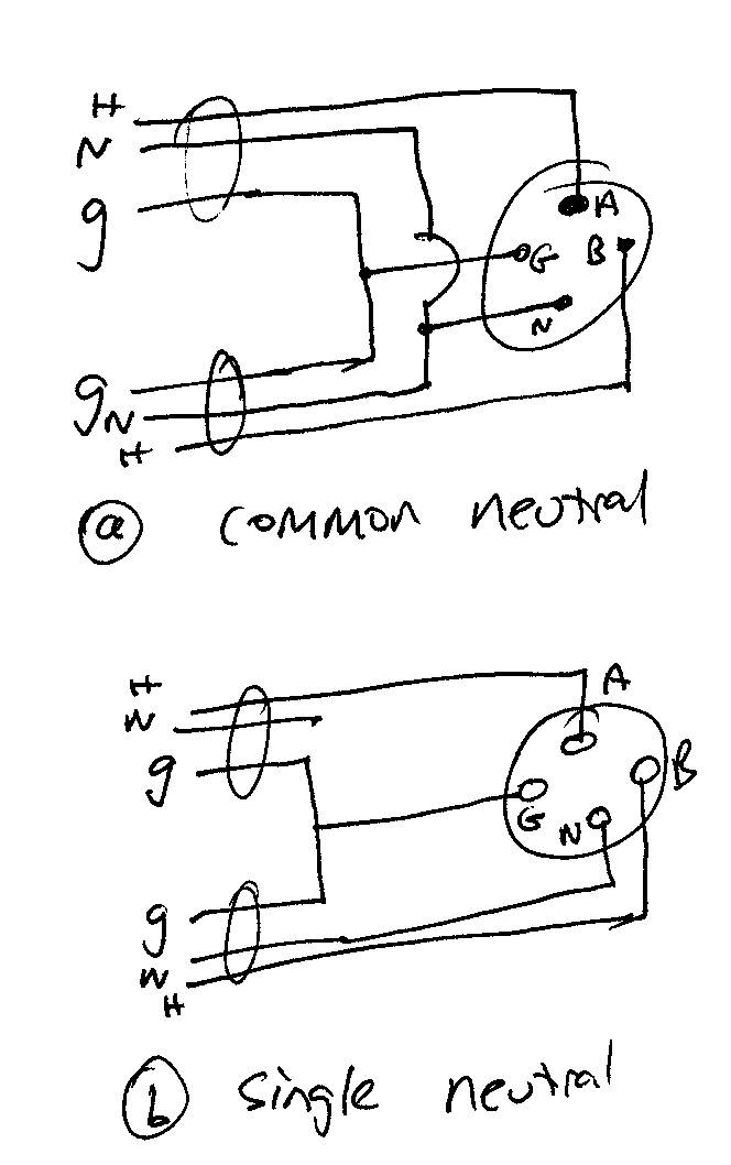

I have a question relating to NEC compliance of a particular type of "cheater tap". I have searched this forum and found reference to a type of cheater tap which is basically an 30A/50A adapter, but this breed is more complex.
Referring to sketch A below, basically two 20A plugs (on left) are wired to a 4 pin socket (on right), providing two hots, a neutral and a ground. This is used in situations where a four wire supply is not available, but 15A or 20A sockets on separate circuits are.
As an opening question, are there any NEC violations with this thing? Do you consider this thing to be safe?
Thanks.
This thing from Progressive Industries, the ADT230 Cheater Box may be something similar available commercially.

Safe? Only if the both of the 20 amp recps. are wired correctly and no one increases the breaker sizes!
But how often do you find 2 seperate 20 amp circuits that close together and that are on two different circuits and two different phases and both of the breakers are installed side by side along with a breaker tie ?
NEC Violation?
How about 210.4(B)
(B) Devices or Equipment Where a multiwire branch circuit supplies more than one device or equipment on the same yoke, a means shall be provided to disconnect simultaneously all ungrounded conductors supplying those devices or equipment at the point where the branch circuit originates.
*If the two circuits are not from different phases, sharing the nuetral is another violation.

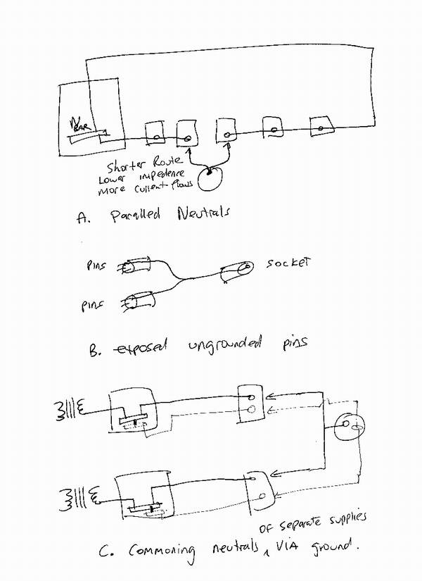

Thank your for your responses so far.
The specific usage I'm interested in is in the rock and roll industry, where amplifier racks are often fitted with a four pole input socket, but sometimes are then used at a venue with only standard three pole sockets, and thus a "cheater tap" is used to enable the rack to be powered from a couple of standard circuits.
I am of the opinion that this thing is fundamentally unsafe, and have been arguing so for some years. However those I argue with say "show me the code violations", which is where I come unstuck, and am asking for help. It may be a bit cheeky, but my original question was deliberately a bit vague :)
I think the thing is unsafe on at least the following counts:
a) It is effectively paralleling the installation's neutral conductors in a way never intended by the installer. This will affect the way return current will flow, see the diagrams below. In some circumstances (example: two premises knocked into one but still two independent installations) you not only parallel the neutral but parallel the otherwise independent grounds, and thus provide a circulating path through neutral and ground.
This is at the root of my complaint, even if the cheater itself isn't unsafe, the impacts it can have on an installation are unknown and will vary from insallation to installation.
b) The neutral pin is common to both plugs, so you effectively have a pin to pin cable. Under UK regs (where I used to live) there was a general principal that all conductors were to be assumed as (and thus treated as) live, and therefore having a "pin to pin" cable would be illegal.
I think this thing is so obviously wrong that it shouldn't be allowed, but every time I look there seem to be more examples of these devices... So I'm looking for code violations that will help me make my case.

A 50A output :eek: I can only imagine they are just tying the 20A and 30A lines together. How do they know 30A won't be flowing on the 20A circuit? And at 30A, a 20 amp breaker will never trip.
When a building is designed, we have to size the service and the feeders for the building loads. When a band comes in and plugs 10KW of equipment into whatever they can find, it kind of makes the load calc. pointless. And at the worst time: when the place is jam packed, the HVAC is running full blast, and every cooler fridge is running full blast trying to keep the beer cold.
