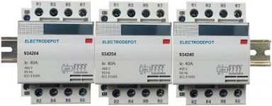

Does anybody have any suggestions on how to have an entire panel dedicated for Christmas lights be controlled by one timer.
I'm thinking just 103 pole contactor with 120 volt coil that's hooked up to a timer anybody else done this before I have any suggestions

I think some kind of timer controlled contactor is about as easy as you can get.
However, it means you have to put all your Christmas lights on the same set of branch circuits which might not be all that convenient.

Can you elaborate? Why couldn't I just get say a 3 pole contractor to feed a MLO panel with standard branch breakers?

Forget to mention that we will be installing new branches off this panel for lights

If entire panel is only for lighting and desire is to shut it all down with one switch a contactor that can handle at least rate of main feeder breaker. Timer controls the contactor. Done all the time for commercial lighting panel so one switch can turn off the whole thing.
