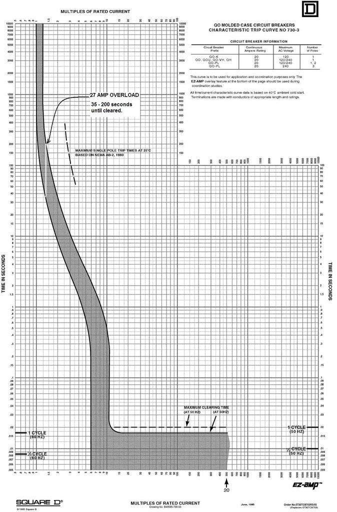

I plotted the 27 amp overload on a QO breaker's trip curve. You can see that the breaker will take between 35 and 200 minutes of this overload before it will trip:
Is that not seconds ?? 200 seconds ?

The NFPA and UL work together, they are well aware that breakers do not trip right at the rating. The rating we see in 310.16 takes all these things into account.
My reference is NEMA AB-4, "Guidelines for the inspection and preventive maintenance of molded case circuit breakers used in commercial and industrial applications."
Section 5, Test procedures.
5.5.4 Test, table 5.3. The maximum trip time for a >250v 20at rated breaker at 300% of the rated current is 50 sec if one were to to field test the breaker.
However, the trip curve as included in a previous post provides a very good example as to what would be expected with the current as measured.
I believe it should provide a rude awakening to most that these devises do not spit hairs as illustrated by the 35-200 sec trip time bases upon the calibration as allowed.
And now to throw in a little extra twist, that's at 40deg C 0r 104degF The trip curve will slide to the right as the ambient temperature is decreased, 25degC=77degF, 20degC=68degF.
In other words it will be even longer. A breaker with a 20at trip rating calibrated at 40degC will have a 22at rating a 25degC.
So if there are those asking for an exact answer there isn?t one except to be aware of the variables and to anticipate where a breaker is expected to trip based upon the calibration range as included with the trip curve of the breaker along with the ambient temperature.

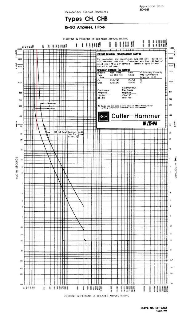

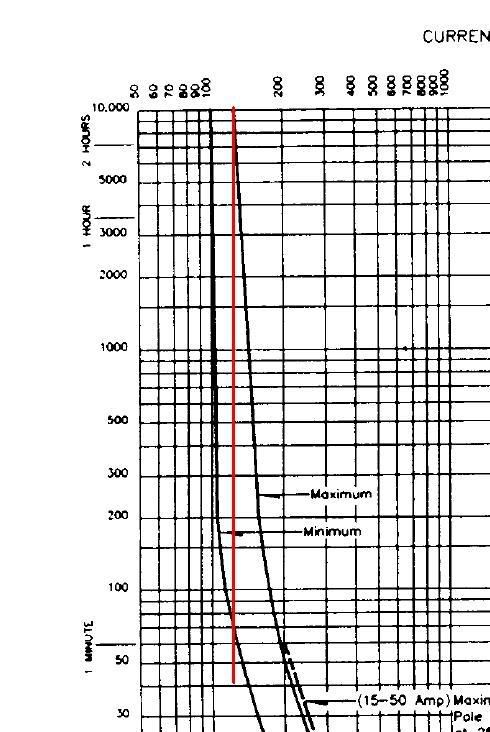

Here is the time/current curve for the Cutler-Hammer Type CH breakers. It appears somewhat longer than the QO.

Looks like the CH is on the "forever" portion of the curve for 135%. The QO was almost there, and if it was cooler, it probably would be.
