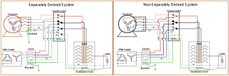

Large generator to a commercial building. There are 6 ATS. GFPE protection to the 5 Service disconnects. Two of the ATS are 4-pole. The others are 3-pole. The 3-pole loads do not have a neutral. Is this compliant with the NEC?
