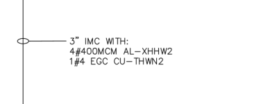

Conduit/Wire Q
Alwayslearningelec
NJ
Estimator
First time I'm seeing IMC, just an FYI. Does it make sense they are showing two different insulations and also aluminum and copper for? Seem like this is a mistake,
