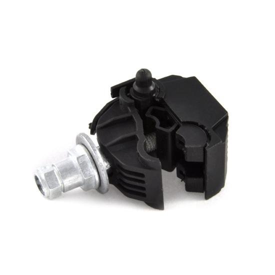

Here is an example of a metering company selling a tap connector specifically for connecting their meters on a service conductor tap.
Not sure about their listing, however.

As far as hooking up the voltage side, I go with Winnie. Use the piercing taps he proposed. Make sure you size the wires to 240.21 and terminate in fuses.

As to those piercing connectors, that would be problematic in my opinion:
  • Is this product UL or CSA listed?
    No, this product does not have any such certifications.
