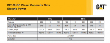

Many large 3 phase generators have multiple wiring configurations, and one of these is the 'double delta' configuration which gives single phase split output. This uses all of the phases of the alternator to produce single phase output, though at reduced capacity.

Thats interesting. Our sister organization ordered an 88KVA unit from the Cat dealer in Port-au-Prince. They told us that they purchased it as a 3 phase unit and the dealer "wired the windings for split phase". My boss and I discussed this as a solution, but to us it sounded like a "field modification". But maybe it comes from the factory with this option. Do you have anymore information on this? Like an OEM manual or anything.
We are probably going to order a Cat DE150 GC 60Hz which is listed as a 3phase. It has every voltage listed under the sun, so I am assuming it has a double delta config. This would be the best solution.
Ive been searching for an owners manual for the Caterpillar DE 150 but there is nothing online. Must be behind a pay wall. I'll send an email to cat and try to get more info.

If you are buying a new generator and haven't bought it yet, just order it with an oversized alternator so you get the KW you need when its wired to single phase. The issue with reduced capacity (by 1/3) when in single phase has to do with the alternator windings, internal wiring, and breaker and nothing to do with the engine.
For example I have a couple 70kw gensets that have 120kw alternators on them so they can supply full current when operating in single phase mode.
