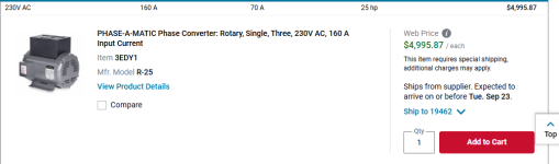

2-If it is a 180A unit, that would mean if I used a phase converter to convert it I would need something sized like this?

Sure I could make it work, and enjoy doing it, but this guy is never going to pay for all the time and materials, and it will never be efficient. God only knows if it is efficient running on three phase. And does this guy even have enough single phase power to run it? I's got to require mat least a 125 amp 240 single phase circuit to make it all work.Screenshot 2025-09-11 161759.png
I was wrong. try 160 input
