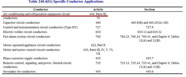

Does the code allow numer #10THHN as the branch circuit conductors for a central air conditioning unit requiring a minimum ampacity of 26 and both a minimum and maximum hacr rated overcurrent protection of 40amps? My understanding was that this would require a #8. Am I misinterpeting the code?
