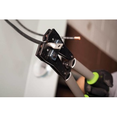

Hello, its our 10th year in business and we do about 90/10 resi/commercial. I have a panel move that now requires extending the 4awg GEC due to site conditions and I'm looking into what crimper I need to do this. The battery powered 5/6k options are definite not in the budget to purchase, I will rent one if I have to. I haven't needed one before and may not again for years. That said, does anyone know of a manual (hydraulic) crimper $500 or less that's listed for use with a listed grounding crimp? Many thanks
Talk to your local supply house, usually they will have a crimping tool that can be rented.
I can rent one but I'd prefer purchasing if there is an option to fit my budget as it may come in handy down the road. Thanks.
Greenlee makes a variety of manual crimpers for under $500. Here's one that under $300 on Amazon:

This was my first investigation and from the greenlee site it appears it only does buttsplice type splices none of which listed for grounding..
This is listed for bonding and grounding. You would just need to find a crimper that is listed for this particular butt splice. I would assume that many are so listed including the ones made by Greenlee.
Thank you the k05 is indeed rated for these

A greenlee k111is about $240 will crimp #8-#1 copper or #8-#4 aluminum lugs or butt splices. An ilsco ct-4 splice will work fine for this.
I picked up an ilsco MT-25 tool years ago at a pawn shop for $21. Not as good as some other tools, but it's probably worth $21 just in scrap weight :)
If you need to do this on rare occasions you can get cheap crimper. I hate to say it but Harbor Freight sells them almost as cheap as some of the crimps. This one if $56.00
I would get it if I only had one or two crimps to make
Thanks everyone I'm leaning towards the MD6 by burndy since it could be also used for service conductors. Found one on the new brand new for 366. Any thoughts on why or why not? The k05 is limited in size of conductors, same with k111. I'm planning to be alive/in business for 40 more years God willing so trying to make a good investment..
