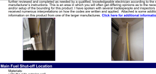

I have never bonded or grounded a CSST gas pipe. It came up on an inspection report. From my research I believe you try to find where it connects to solid pipe, and then you install a normal water pipe style grounding lug. The inspector told the realitor, oh its easy you clamp a bond from the CSST to the hard pipe. I dont think you are suppost to put the clamp on the CSST....?? Or are you. If so where do you run the ground wire?
