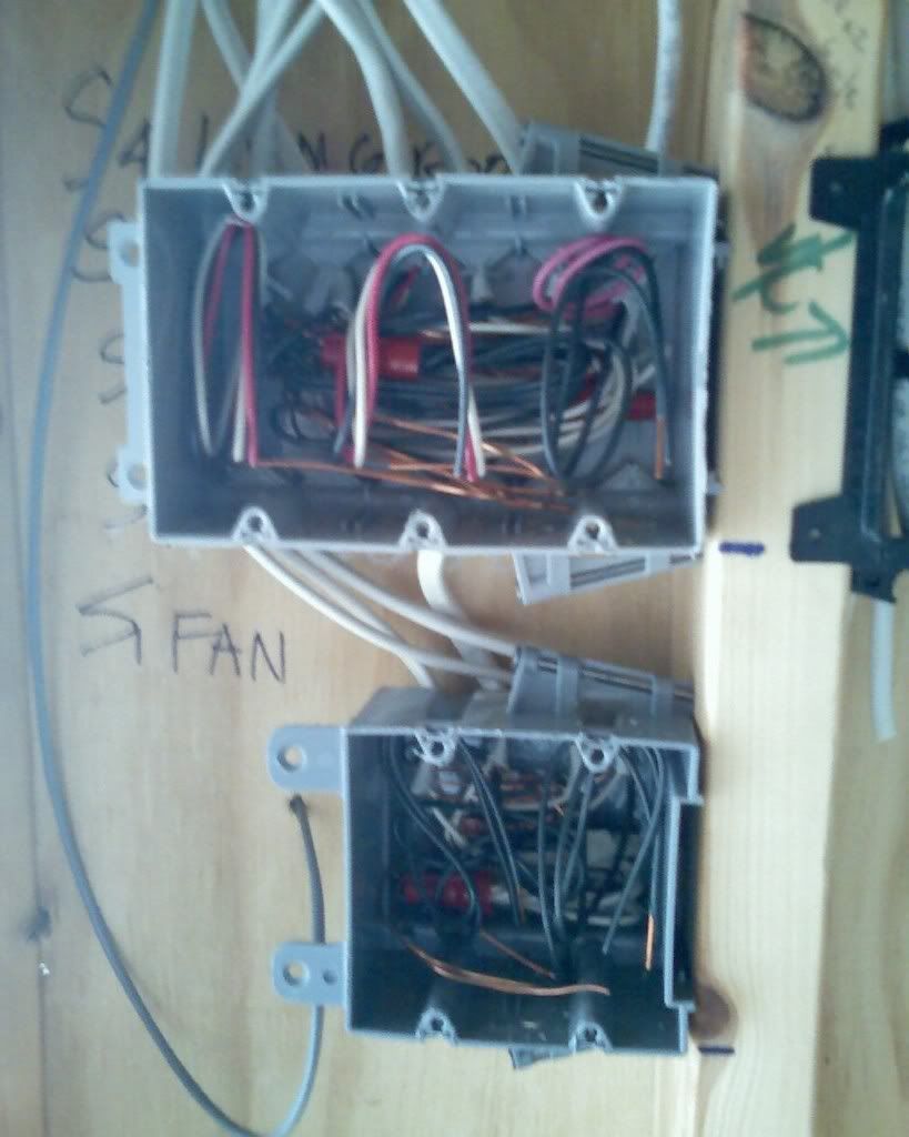

I have a few "identifications." On a GFI I will sleeve the line side. Years ago when the line and load screws were left and right I would put the wires in the box accordingly, but they messed me up when they switched to top and bottom. :roll: Single pole switches get the feed stripped out so I can put feed on bottom and switch leg on top. (Doesn't matter, just habbit and system.) 3-ways no real distinction unless I have red and black travelers and then I will strip common for quick identification. (Assuming a black common which is 99%.) Outside of that I try and keep wires folded neat and separated.
For those that may ask, I do not pre-strip wires at rough-in because after enough restripping for paint cover and roto zip nicks I just save it all for trim. Do it once, I say. :)
http://i221.photobucket.com/albums/dd94/SurfSideEC/03-26-07_1839.jpg
