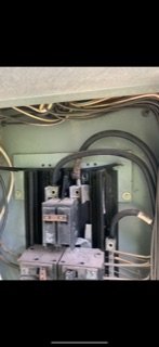

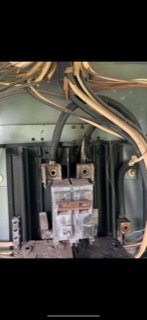

Hello everyone. I do a lot of work for a property management company and on one street they manage around 10 duplexes. I’ve replaced two load centers now where the right line side lug is overheated and basically melted out. I was out there again today and found another panel that was almost identical. Any thoughts on why? They are all old Gould I-T-E panels.
