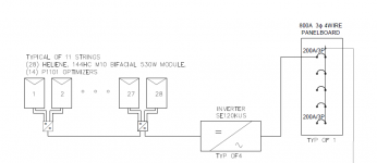

It would be fantastic if you could give me some ideas for a DC home run instead of an AC cable from the rooftop to the ground.
The customer design engineer desires a DC homerun from the rooftops to the grounds. He prefers that all of the equipment be put on the ground rather than the roof.
We have seven 60KW AC inverters, each with eleven strings. I suggested putting all the inverters on the roof and running an AC wire instead of a DC cable. This will be less nos of conduit and cable and a cost-effective and low-voltage drop solution, but the customer's engineer declined and wants to run the DC cable from the rooftop to the grounds.
Does anyone know what the benefits of installing DC Homerun are?
