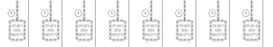

If you were required to demo branch circuits(safe off and disconnect) per drawing/note below would you want a panel schedule showing the branch circuits or would you feel comfortable allotting time just knowing it's a branch panel board and guessing on branch circuits?
I would want to know how long these branch circuits are and where they go and how accessible they are. Like if they are all surface mounted conduit in a boiler room that's very different that if they go behind walls.
