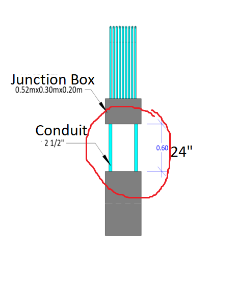

E EmilianoAO Member Location México Occupation Electrical Engineer Feb 15, 2022 #1 Hi everybody, i have a doubt does this code reference still apply? * if it ends at a junction box? *and if it ends at a duct it counts as a raceway?
infinity Moderator Staff member Location New Jersey Occupation Journeyman Electrician Feb 15, 2022 #2 Are you asking about the two 24" raceways, what do you mean by duct?
E EmilianoAO Member Location México Occupation Electrical Engineer Feb 15, 2022 #3 infinity said: Are you asking about the two 24" raceways, what do you mean by duct? Click to expand... Hi yes, i mean duct as wireway. like this https://download.schneider-electric...Name=5100CT0101R7-11.pdf&p_Doc_Ref=5100CT0101
infinity Moderator Staff member Location New Jersey Occupation Journeyman Electrician Feb 15, 2022 #4 A wireway is a raceway but it allows up to 30 CCC's before you need to derate.
