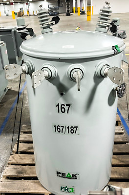

Fronius inverters do 1000v strings on their Single phase inverters, you may look into that. Also I think some XHHW is rated 1000v so you could look into that instead of PV wire. If you did go with PV wire, keep in mind it's available in AL. Honestly without running Any numbers, I would guess that would be your most cost effective option. You could step up to MV, say 7200 and use a single #2 CN cable which is only about $3.75/ foot, but the cost of the transformers will probably kill it.
Just for some comparison with transformers, this is probably the most cost effective option you will find. These are nice new surplus units , I actually bought some smaller ones from this same place for a residential setup / step down recently. You can just set them on the ground and build a dog house over them. Well worth the cost when you compare to the cost and lead time of pad mounts.
