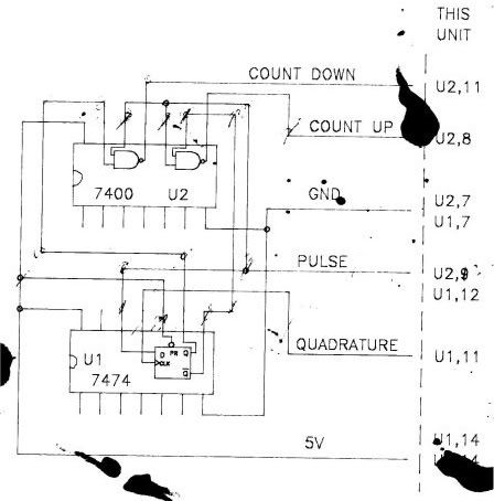

here is a picture of a drawing I made in about 1987 in my basement:
The smudges are ink from trying to unclog drafting pens.The drawing was made on a flat bed plotter that held eight pens of different colors. Man, I loved that thing.
My point in all of this is that there is a long way to go from posting a link that shows drawings of perforated discs, LED's, sensors, and chips to getting a working prototype. Longer still to a reliably performing "solution" .
From your last post , I got a kind of "see, you can too do this for a buck ", "rubbing your nose in it", feeling.
I don't want to discourage you, but whatever you try, you are probably not the first person to try it... and neither was I. I just didn't realize it at the time. I spent a whole bunch of time on stuff like this, that I probably should have spent on the floor with my kids.

Of what I understand of your project, won't you also need a "coding" for no motion. If you only have 0 and 1, then your circuit will likely tell the drive it is moving in one direction or the other and never at rest. I believe you have to move up to 2-bit detection coding if staying in the digital realm ;)
