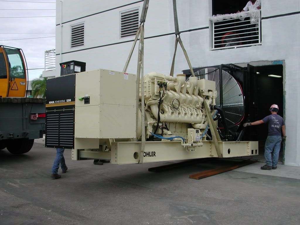

I want to answer a couple questions from this thread without hijacking it.

Anyway, how does that fan blade move any air, it appears to be flat.
The fan is inside the large black enclosure along with the radiator.
It moves so much air I strongly recommend safety glasses along with ear plugs when you fire these up.
Also make sure the generator enclosure itself is spotless and everything is secure. Anything loose can be blown into the radiator.
Here are the specs.
I was working in a sewage lift station that had one of these installed. Entire room was nothing but walls of louvers. When it fired up, it moved so much air that it was impossible to stand upright without grabbing something solid to hang on to. More like a wind tunnel than anything.
I am not a professional rigger but to my eyes they are misusing those straps and should be using the provided lifting points. I would also be telling the guy to get a ladder.
Good eye Bob. The mechanical contractor did the rigging. Those straps are 9000lb rated each. We were very nervous about that lift. This genny was 30,000lbs, 29,000lbs in the crane cab. We had a 36,000 pounder drop a couple inches back onto the flatbed a couple years ago when the straps snapped.
I agree Iwire. We have to use spreaders and slings in the factory holes. We have a very good crane company that sends out good riggers on every large lift I do. They do a better job than my guys because they know exactly what slings, chokers or chains to use.

My main issue was that the straps are wrapping around hard corners, I do see they have some protection on the edges but I would have wanted to see steel bars run through the holes in the frame and the straps run to those bars.

I was not too thrilled how the riggers used that strap like that it can really destory the generator like that they should used the factory hole and spreader bar.
I would also tell the rigger not to stand on my genny. But after I wire her up, my footprints will be all over her.:D

We lifted the 1250 two weeks ago and set it on a low boy for a temporary EM source until the 1000's are online, spreader bars and the factory lifting holes were used after pumping most of the fuel from the 2000 gallon day tank to get the weight down to around 53,000 lbs from 64,000 lbs.
The crane was a 100 ton.

Had a 400KW one time that was supposed to be set up for a push thru fan. The radiator was ducted thru an outside wall with gravity louvers. CAT startup man started the unit for the first time. It didn't take us long to figure out the fan was pulling instead of blowing, I'll never forget that sound.
I got in trouble from one client even while using lifting bars and straps. they made it clear that they wanted us to use lifting eyes only from the factory lifting points.
I had one that was for a cellular switching station, the engineer for the job called for motorized shutters at the end of the genset. I was called in when the generator vendor said the shutters were not wired correctly and were not working, when I got to the job and seen where they were located, I knew it was not an electrical issue, the generator started much faster than the butterfly shutters could open, causing them to be blown out of the frame. gravity shutters should have been specified, as the owner would not allow a time delay to allow the shutters to open fully before the generator started. They went back to another site that this engineer had designed and found the same problem.

I agree there is no protection on the corners of the skid were the strap goes around and i see from the pic the one strap has damage to it. I do not know if the red string is showing but looking at how much its frayed i bet it is. You don't need a spreader on that load and the strap angles look very good.
