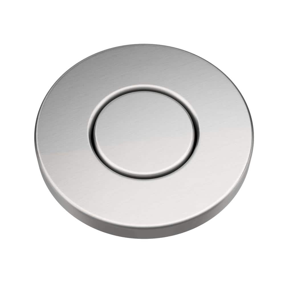

Can you use a pneumatic switch kit, and feed the under counter receptacle with a GFCI breaker?
Or, can you use a standard wall switch and feed the circuit with a GFCI breaker?
