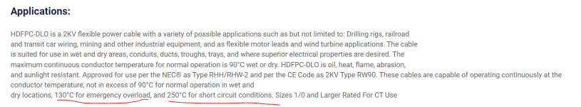

I've always been told DLO/Welding cable/very fine stranded copper conductors have a higher ampacity than their courser stranded counterparts, but I cant find anything to support that. Customer wants 400amp fuses replaced with a 500 amp fuses, load side is parallel 4/0 super fine stranded conductors that go to a cable tray type cable. (I say cable tray type because its in a cable in a tray, but not tray rated, its part of a skid). According to 310.16 my 4/0 wire is only good for 230 amps. Is there anything I'm missing?

Not really ... you get those same ampacities when you use 310.17 and the 90°C column. If you look at the typical data for 4/0 DLO you would find almost always find it rated at 405 amps.
Southwire gets into it in their DLO cut sheet.
It seems you would be correct in the notion that DLO has a slightly higher rating, but it is a negligible amount IMO (more like 1-5 amps difference but definitely not 100.

The Conclusion I've come to, is the insulation on DLO can handle more heat than your everyday THHN, but that doesnt help you when sizing wire with the NEC. My terminals on my breaker are 75 Deg C, so this higher temperature capability doesnt really help me. Thank you everyone
